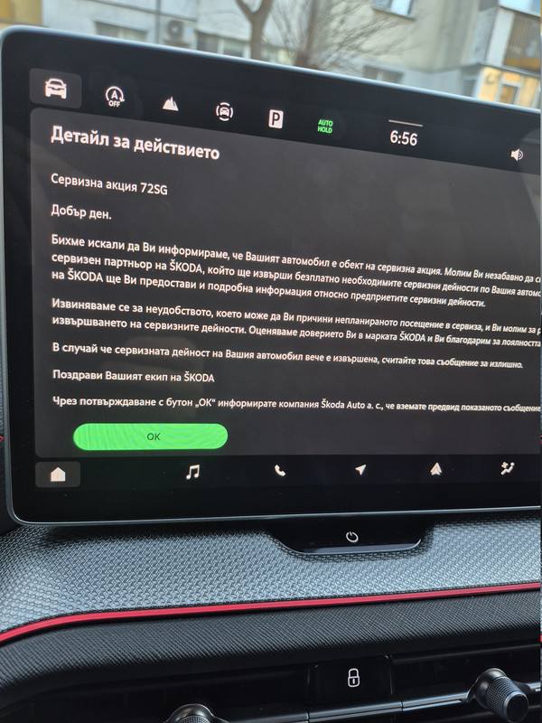

Based on available Skoda service information, the 72SG service action refers to a recall campaign concerning the Takata airbag in certain Skoda models.
Here are the key details regarding this action:
The Problem: Defective gas generators in the driver’s or passenger’s airbags (manufactured by Takata) may deteriorate over time due to heat and humidity. If the airbag deploys in an accident, the generator could burst, causing metal fragments to fly into the passenger compartment, posing a serious risk of injury or death.
Affected Vehicles: Primarily vehicles produced roughly between 2012 and 2018.
Action Required: Skoda is conducting a proactive recall to identify affected vehicles and replace the airbag components for free.
Recommendation: If you believe your car is affected, you should contact an authorized Skoda dealer immediately to have your Vehicle Identification Number (VIN) checked and the part replaced.
https://recallactions.skoda-auto.com/451/bg-bg
https://www.skoda-auto.com/services/recall-campaigns
Ако въобще е това де. На горниите линкове можеш да си я провериш, колега. Има обща проверка и отделно по отделни кампании.

Става въпрос за следното:
Campaign Number: 72SG
SKODA KODIAQ Model years 2025-2026
Recalled: 19 Feb 2026
Statement:
For Škoda Kodiaq vehicles from a specific production period, there is a risk that the edge of the inner frame of the front seats may compromise the integrity of the side airbag when activated. This may reduce its effectiveness.
For safety reasons your vehicle must be repaired. The vehicle will be fitted with sharp edge protection for the inner frame of the front seats to prevent damage to the integrity of the side airbag when it is deployed.
